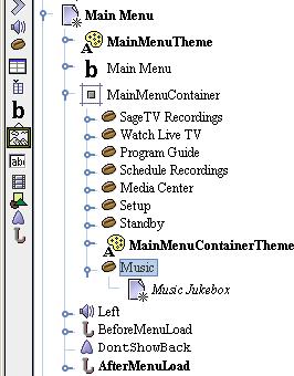

1. The first step is to open the Main Menu from the alphabetical list of menus in the browser.
2. Now drag a new menu item widget ()from the widget bar on the left side of the window onto the MainMenuContainer and name it "Music".
3. To finish just select the "Music Jukebox" menu just below the "Main Menu" in the browser and drag it onto the new widget item you created.
The picture on the right shows how the main menu looks after customizing.
